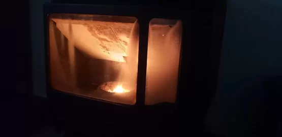

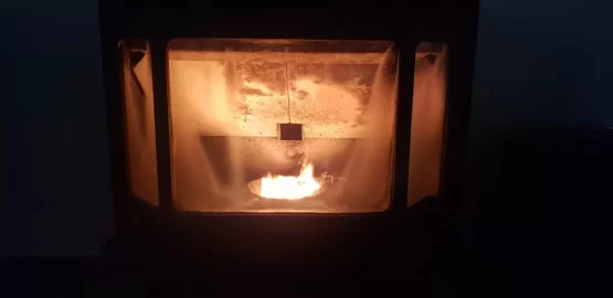

Anyway I am curious how quickly the glass should get dirty. I cleaned the stove and the glass completely 3 days ago. The stove has rna about 36 hrs (12 hrs a day) since.
Attached some photos of the ash buildup on the glass. You can see where the air wash is washing it away in the middle but not the sides much.
Gaskets are all tight. Is this normal? Or should I expect the glass to stay cleaner longer?
Thanks all

Depends on the pellets too. Last pellets I burned the glass would be plugged solid in a day or less. Current pellets I can still see through the glass 2 weeks later before I clean it.

I don't have the same stove. I have the Castile model and would consider that normal for my stove.

There are a few factors that affect how clean the glass will stay
The intensity of the fire hot = cleaner.
Type of pellets top of the line = cleaner glass
How good the air wash is, also affects the glass
The build-up you have after 36 hours I would say is better than average
to average
How clean the glass stays is not important to me the heat I get from
every pound of pellets is

It can vary stove but stove. My glass on my pp130 would be similar to yours. My ussc 6500 gets dirty about twice as fast.
The cleaner the stove the longer the glass will stay clean due to cleaner/more efficient burning of pellets

Agree with the other posts and I would also add that it looks like the air wash slot is a bit clogged on your stove. It happens. See if you can find the slot where the air comes in and clean it out with a thin piece of wood or plastic.
