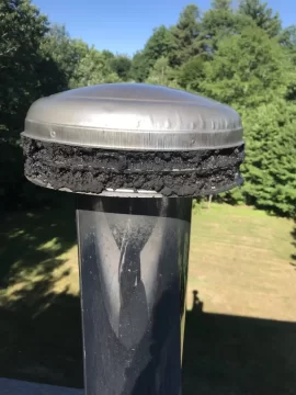

So an update, got up on the roof this morning before work to inspect and clean the rain cap. The cap was definitely the source of all my problems!
Here is a picture of the issue

still I would not think that it would leak out seams, back draft out stove yes. Still the issue of the creosote formation. The fact that it was dripping and running down is a cause of major concern. Major problem waiting to happen. that has to be the worst I have ever seen

The professional was wrong. Even with a plugged cap there should absolutly be no smoke or creosote leakage from the joints.
Then possibly the upstairs is acting like the top of the chimney, bypassing the blockage? Cant believe it would draft enough to run the stove though. Sounds crazy.

Several years back we had a screen plug up like that after burning some wet maple, but there were no creosote leaks. Instead the flue just stopped drafting and the stove spilled smoke badly when the door was opened.
