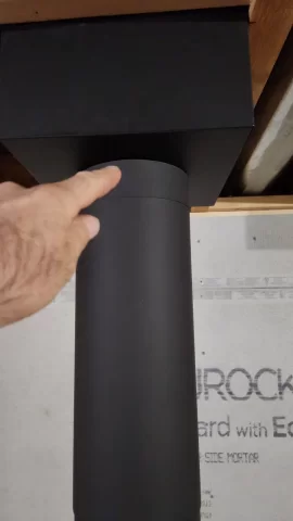

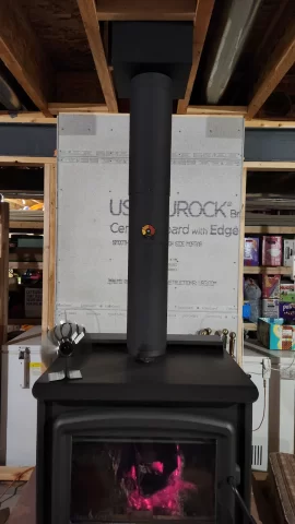

I wanted to chime in here since the original question started as whistling issues during a wind event. I have double wall pipe. We are currently, as I type this, having a wind event. I am getting a whistling sound where the pipe connects to the chimney in the black box on my ceiling. Any ideas anyone? I will attach a couple pics.
