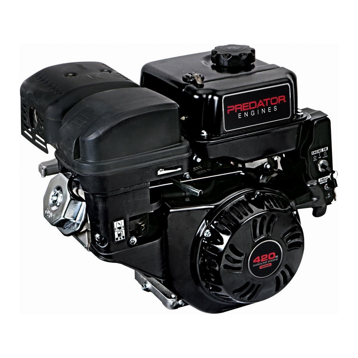

I'm no help with the OEM engine...but If you have some basic fabrication skills, I'd consider swapping to a horizontal shaft engine (I'm actually doing that on a Huskee 22ton now)...I think you'd have to buy a pump adapter, but those aren't expensive, and maybe change things around a bit with the hoses...but horizontal engines are cheaper to buy, and you'd have a much better selection...personally I'd put the 13 HP Predator (Honda clone) on it...they have a great reputation, and can often be bought on sale, or with coupon, sometimes both.
