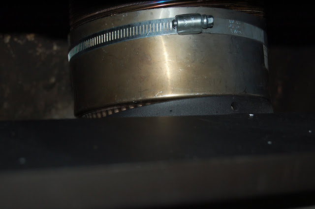

    If you look at the op's pics in the first post, it doesn't look like the insert has been pulled out. It only looks like the surround over the stove was removed.
    Furthermore, I would say it has been like that from day 1. Chances are, there was enough temperature differential (inside/outside) when cold to make th draft pull even when not in use. When it was first lit, it was drawing most of the smoke, but some of it still leaked into the room. As the temp built up in the stove and was released, it increased the velocity of the draft, therefore sucking it out more efficiently.

    With smoke spilling from the surround from day 1 it HAD to have been like that. NO smoke can get to the area behind the surround WITHOUT a breach of the exhaust system. It ain't possible unless he was cooking off something else or the stove had a crack in it. If at the broken joint it did get smoked up, it was probably cooked right back off once the stove started to come up to temp.
    You are very lucky, my friend. This could have ended in a very bad way.
    That is a craptastic install.
    Oh, and how does this differ from an open FP - you now have a 6" flue instead of the original size flue to exhaust gasses. The exhaust "system" for an EPA stove is based off of a completely different set of requirements than an open flame.

    The insert has never been moved since it wsa installed. This insert extends out from it's trim 8" onto the hearth, so in the pictures you can see that I merely removed the top trim piece.
    I have to say though that I thought one of the points behind a flex liner is that if I needed to reposition the stove, the liner would FLEX and not pop out of a joint. Further, shouldn't a joint be fastened so well that the liner would flex before popping out of the joint? This joint appears to have simply been "plugged in" to one another....I have no idea how it was supposed to actually be sealed.
    My BIL mentioned having it redone and using aluminum tape or similar at the bottom. Can that withstand the heat?

    First off: Holy Crap! Glad no-one was seriously injured from that. I don't know squat about CO poisoning. If I were u I'd be seeking out some good advice whether repeated/chronic exposure can have long term health effects. If so I'd seek medical evaluation. Also vote that your CO detector is faulty/expired/out of batteries.
    To your questions. The point of flex liner is that it flexes enough (ussually) to get it stuffed down a chimney & through a damper. Some brands flex more than others, but no, you can't move the stove any significant distance with it still attached.
    As BB stated, that looks to be an Adjustable Elbow used to make a connection where things don't line-up very well. The top part of the elbow can spin around to get the right angle. In this case the installers look to have wrenched the flex liner into the adjustable elbow under a lot of force. The flex liner was too far out of line from the stove collar, but they forced it in there anyway. That caused the elbow to fail and come apart. When that happened is unknown of course, but you have evidence that it happened very soon after install.
    AL tape has different temp ratings depending on type. I don't think there are any that would be rated for the temps you'd see at the stove collar. Furnace cement is the only 'sealer' I'd trust there. As stated I would not trust an adjustable elbow at all after seeing that. Install needs to be re-done so the pipe lines up properly with the stove collar and all connections are solid. Also I'd demand an insulated block-off plate be installed for free (unless already there), installers explain how they are fixing this and have a 3'rd party inspect on their dime.

    FYI, the one thing the installer said to me that didn't jive with hearth.com was that "A block-off plate around the liner doesn't make much sense on a convection stove. The jacket around the stove will insulate the stove already and you are getting your heat through the hot air blowing out from around it."
    I blew it off at the time since i was planning on doing a block-off myself. Now it makes me wonder about him.
    Also, my block-off plate is going to be simply rock-wool shoved up around the liner to create a really thick maze for cold air to get through to hit the stove. I'm also going to layer rock wool around and behind the stove so that it operates within a "cocoon" of insulation. I will probably face the inside of it with heavy duty aluminum foil as well, but not sure if I even need to do that.

    The difference in these two scenarios is that with an open fireplace, the flue is open. With normal draft the combustion gases always head up the chimney. Your flue is not, it's capped at the top. Combustion gases either head up the flue pipe or out into the room. It appears that the only thing that saved this from being a disaster was the good draft on the flue.
    joe, it would just be speculation on why this happened, except that for sure either the elbow was under high tension or damaged on installation. The clamp being on the liner only is a good indication this is the result of sloppy, careless workmanship.

    Yeah this is a totally unacceptable install. I would be quite surprised if it really did leak CO into the house though... that is essentially a badly made "passive damper," which is bad practice but was done by seat-of-the-pantsers for decades, even on oil furnaces I've seen. I'm sure it would leak on startup but once the liner above is hot it's going to vacuum anything out of that void. The vacuum generated by all the pipe above that point is vastly greater than the pressure created by a lazy under-drafting fire. All the draft you were missing in your stove was working to pull warm air out of your house up the chimney.
    Maybe just maybe when it's down to just coals and if there is no cap so the chimney cools fast, and you underfed air to the coals, maybe you'd get some CO then. But I'm not surprised at all that the detector never signaled. And to put your mind at ease, you weren't getting sick from undetectable levels of CO. I don't think you needed God's help here, physics did fine. Now that installer maybe better start praying because you have a great case that they flat out ripped you off with that kind of "install."
    I don't see it as terribly dangerous in this case, but it is undoubtedly why the thing didn't really work.

    As for the elbow being used, I would not trust it. I have used a similar type in running HVAC ducting in my attic. If placed in a bind, the seams in this will pop apart. I saw a flexible elbow at my Tractor Supply that I would trust, but can't find it shown online. This was a black flexible elbow that is made like an accordian. It is all made from 1 piece of metal and can be bent by pulling/pushing on the accordian part of the flex.
