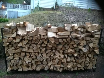

If you have the space, single rows can be very effective. This gets sun on both sides and wind blows from west to east through the wood. It has better air flow underneath, too.
(broken image removed)

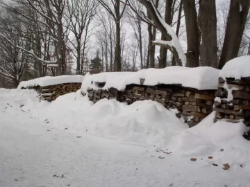

[Hearth.com] I think it's time for me to start stacking in single rows I'm trying a new technique, 2 rows on pallets, with a space between them.
New is; I lean the stacks slightly together to where the meet at the top.
Then a row of bark up birch down the seam.
Hoping to keep some rain & snow out of the center.
Last year the space was packed full of snow.

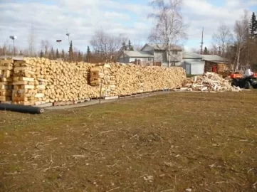

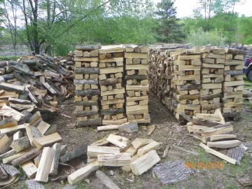

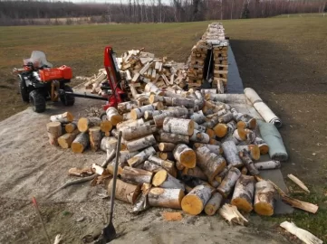

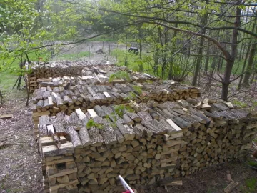

I'm not convinced yet and have stacked wood this way all my life. Well, most times in 3 rows together but have stacked with over 20 rows together. Never have had a problem with wood not drying. Many claim with the 3 rows that we typically use for stacking that the center row won't dry. That may be true but I've found it interesting that the wood piles shrink down at the same rate. It would seem if that center row did not dry that it would end up higher. That has never happened.
Here are a few examples and for added emphasis, in the first three pictures, those were stacked right on the ground. Nothing under them except good ole Mother Earth. Naturally the bottom row and mostly the bottom 2 or 3 rows would be frozen in when we got down to them. No problem. Wait for spring, throw those on top of the new piles and they would be fine the following year.
