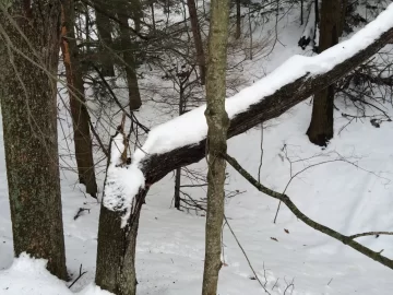

I'm assuming this is pretty common. If a tree falls but doesn't make it all the way to the ground, how do you cut it up with a chainsaw?
This is a nice little oak that's been dead for a few years. It's hung up in some hemlocks and I would like to cut it to add to my stacks. I was hoping someone had an approach they use in situations like this that might save me the never ending learning I do by trial and error. Thanks in advance. Here's a picture or two. [Hearth.com] If a tree falls in the forest: Advice on "leaners"
You usually need to approach every leaner a bit different. Some leaners can be very dangerous and often not worth even dealing with, but that one looks safe enough and might be a good practice tree. The main thing you have worry about , besides getting hurt, is pinching your saw and getting it stuck. Usually people will cut from underneath cutting up, or at least finish the cut from underneath so the cut does not bind on your saw.
I would probably measure and start my cuts on the top as far up the trunk as I safely can and then finish the last one underneath so the trees falls to the ground,,,, then you may have to start repeat the process until you can get the top of the tree all the way on the ground.

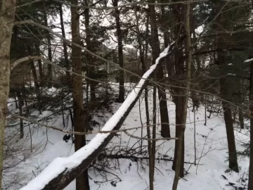

Here's the "big picture" if it changes up the suggestions. Thanks again!
I would top cut about halfway through and then undercut your way up. It is going to be a process though, and it may not be worth the risk. Did you consider felling the tree it is stuck in? If you decide to undercut it make sure you're not alone.
Cut it at the base and come along it out of tree
That can be dangerous. Every cut the tree wants to fall, and you have to be sure it is not falling on you. As lumberjack said you cut from the top, finish at the bottom, but it will want to fall and bind at the bottom and chain will be above the ground and can come back at you. If you can use a come along to pull it down first it the best bet. I am lucky I have a Bobcat and I can push it or pull down at the base then I hook a chain up and pull it backwards until it comes down.
I cut the trunk at a height of around four feet above ground, where I can comfortably cut and easily back away from the tree as it falls. Start the cut from the top, stopping about halfway through. Finish the cut from the bottom so the log doesn't pinch the bar. When you are making these two cuts you will leave a hinge similar to the hinge you leave when you fell a tree.
The top of the tree will typically fall to the ground near the cut, and in many cases the tree will still be a leaner. you repeat the process as many times as necessary. Be careful as you 'walk' the tree toward the place it is stuck and the trunk becomes steeper. Eventually you can walk the tree to a vertical position and it will fall over.
It is possible to make your cuts at an angle so that the leaning trunk falls to one side of the axis of the lean, rather than straight down. Depending on how the tree in hung up it might be advantageous to walk it to one side or the other so it falls sooner. You can make the top cut to one side or the other, then the bottom cut parallel so that the hinge that breaks as the trunk falls directs the fall to one side or the other. This is hard to explain, but when you're out there cutting the tree you'll see what I mean.

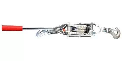

Just saw your comment , yes you need a come along. Get something good. I don't know which come along is good. They generally don't unwind well. I use a 1 ton chain tugit.

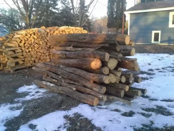

Last weekend I took several leaning locust trees down using the method Wood Duck describes above...several of the leaners were 20 feet or more of trunk and I had to patiently work them to the ground cutting about 7.5 feet at a time depending on the amount of lean.[Hearth.com] If a tree falls in the forest: Advice on "leaners"
With sound wood...I'd start cutting on the top till about 3/4 through than finish from the bottom...Be careful gravity and ravines can gang up on ya. ;-)

I have a cheap o come along and some nylon straps.
It has pulled things for miles about an inch at a time.
It couldn't have cost much.
