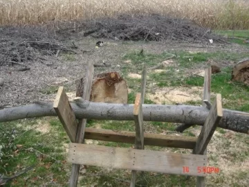

    You should not be using saw horse's in the first place. Seems they must be smaller as your getting them on the horse.;) saw bbbbbbbbb.jpg

    I cut only near the dogs. I stay away from the tip of the saw as that kickback is something I never want to experience. I need a saw buck like that sweet one pictured above.

    As you gain experience you can keep an eye on the log. I know when a log is suspended like that, or even on the ground when it is in the air, that it will want to pinch the bar as it reaches the end. I like to find a log up in the air, as it makes for easy cutting (if you are careful). I watch for the log getting ready to move, remove the bar and finish from the bottom (and there is very little fear of kickback from the bottom as the log protects you). Whe rolling the log, I will cut several pieces to length 3/4's of the way through then roll the log and finish them all at once. Dennis loves the cant hook for rolling the logs, I have not bought one yet but could see the benefit. Normally I will get the log to a reasonable size and just push it over when needed. I did build a sawhorse for small branches that I can cut straight down and do several at the same time without fear (it is an H style). I do not have a picture handy but will to try to find a link.
    https://www.hearth.com/talk/threads/my-h-style-sawbuck-holds-alot-of-wood.61191/
