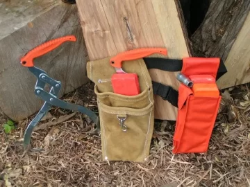

Been using saws since I was 15,felling trees since I was 17.Over 30 yrs. Even now I feel the hair on my neck stand up when I start to drop a big one.You should never lose your respect for certain things or act in a careless manner no matter how much experience you might have.That's when accidents happen.I've had a couple close calls ( few hangups,a small barber chair or two & a pinched bar) but nothing that endangered me,others,any property/equipment. You learn from any mistakes & do what you can to prevent any in the future.
Wedges are a must IMO,both in felling & bucking.Sawbucks are great for rounds/poles up to 8" - 10" diameter also.Much easier for me to carry out 3 to 9 ft poles,load trailer or pickup & cut them on sawbuck later then constantly be leaning over cutting 1 piece at a time then have to bend over AGAIN to pick up & carry 4-5 times as many pieces to the trailer or pickup.

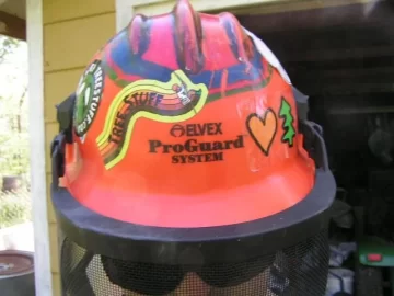

And PPE. Good habits prevent accidents, PPE prevents mistakes from becoming injuries/death. For strictly bucking up logs in the clear, protecting your hands, eyes and ears are a must (gloves, glasses, and plugs/muffs) in additon to chaps and safety footwear (preferably steel toe boots). A helmet system is nice and will keep you from performing a lobotomy on yourself in a kickback situation. It becomes a must if you graduate to felling your own trees.
Here's a couple of safety tips, in addition to wearing a hardhat with face screen or glasses, steel-toed or kevlar-lined (even better) boots, and kevlar chaps or safety pants:

I am real tempted to go over to the dealer and pickup that helmet system, chaps, and Stihl brand gloves.
Due to Master Mech mentioning it, I'm going to get on that today / tomorrow. $160 is a wise move if you kickback or screw-up.. Like I said, flesh protection is cheap on the front end.

I wasn't getting the helmet until the kickback issue was raised. It gives you all in one so really not too bad when you think about it for $60

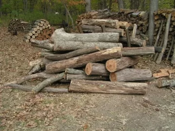

Here's what you should do when the tree starts to fall. As Backwoods Savage points out, you also need to clear an escape path. Some people carry an axe or hatchet with them to pound the wedges in with. I always wind up losing that stuff, so now I do what Soren Eriksson showed us back in the '90s when he was training manual loggers, which is to cut a short piece of wood from a sapling or branch and use it as a club to pound the wedge in with. Another really important thing to remember is that you should never cut through the hinge before the tree starts to fall, or you'll lose all control over it. And if you don't know what I'm talking about, you probably shouldn't be felling trees just yet.
Anyway, I took this photo a few weeks ago on a logging job in northern New York near Newcomb.
