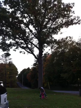

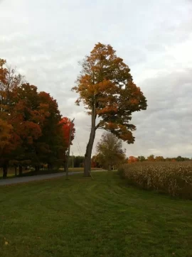

    Are these the trees that you think are out of your league? C'mon, you own chaiwsaw chaps! What could go wrong? Get out there and give it a go and take video.
    p.s. I think that maple is Sugar Maple - great firewood. I am not sure how big your saw is but you might want to have the pros cut those trunks to stove length for you. Even if your saw bar is long enough it will take a long time to cut those big trunks into rounds.

    The tree's along the road I do believe are sugar maples, and I am deffinatly having pros drop them as they are all dead standing. They have been dead for a couple years so bucking them shouldn't be too bad. This is going to be fun and a lot of work, there are 8 or 9 trees around that size to come down!! :) I might even get lucky and take delivery on my new loader before I get started. I am just itching to get out and start my stacks.....

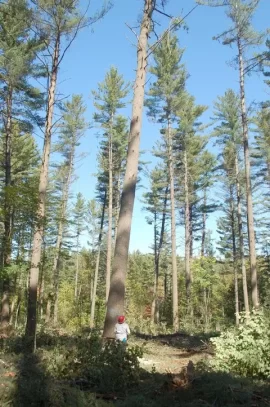

    We may be confusing our terminology. In the following photo, you can clearly see the hinge. If you cut that before the tree "commits" to a direction of fall, then it can fall anywhere & you've lost control of it. Quite simply, you aim the tree's fall with the notch, you get it to start falling by making the back cut, and the(intact) hinge forces the tree to fall where you aimed it. Add a wedge or two to help the process along, and you're probably looking at a successful felling operation.

    Nice Hinge wood... I use to work on DOT's tree crew, we took care of 8 counties from Essex down to Green County. Taking down some big nasty hazard trees at times. I remember my boss would always check my hinge wood after felling any good size trees, ,,,, he wanted them even or holding wood to one side if needed. He'd let you know if you screwed up! He made me a competent feller. That's why your still around;lol I like your Tin Bill cruiser hard hat;)

    See if they are County tree's, they might take them done for nothing. I had a good size declining sugar maple out by my road, at the edge of my driveway,,, was starting to shed limbs. I called, they came and measured the road set back,,,, sure enough it was their tree. They came and took the tree down and left me all the wood, they chipped up all the brush. Was an easy 800 dollar removal. I gave them 100 dollars to buy everyone on the crew lunch. Saved me renting a chipper , etc.

    I'm trying to figure out why that tree fell 90 degrees from where it was was supposed to based on the location of the hinge. Maybe the tree rolled after it fell, but I finf that very unlikely. Also, it looks like the hinge is crushed on the end in the direction of the fall.
    Just trying to understand.

    I see 'em flop over a bit quite often when they fall, especially if there is a big branch on the side that hits first.

    Yes, it flopped when it hit the ground. Good catch. One of those big trees unfortunately hit a rock when it hit ground, ruining part of an upper log--might have been this one. That might be what caused it to twist felling.jpg around.
    Here's what it looked like as it was falling. It went right where he aimed it.
