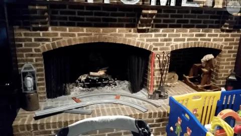

This Is What I'm Working with. I would love to have a freestanding stove but I think a large insert with a variable speed blower will fit my needs better. I do like the big osburn I'm just wondering how it holds up with the other big names. I don't see as much info floating around on them like I do the regency and such.

If it would be me I would try to fit a stove in there or on the hearth. Would look much better than an insert with a huge surround. How high is the opening at the center and the sides? And how deep is the hearth? The mantel may need a heat shield.
Hi fire- All the inserts you mentioned were good choices. Couple more would be the PE Summit, HS Clydesdale. You are going to have to do an extension of the surround. A big old FS stove with a blower might be a good choice too.
Very cool looking Hearth set up you have there. If that mantel is combustible, be sure to look at clearance requirements for the inserts you're considering.
The consensus seems to be get a free standing Stove stuck in there, and I would agree, except the mantel clearance could be an issue. Free standing stoves don't generally have mantel clearance ratings, and often need Hearth to overhead clearance of plus/minus 84".

To me, that opening just screams free standing stove with a rear vent tucked part way into the opening. The height at the centre of the opening will dictate just what stoves, but there are also a numbet that come with short leg kits. Search for some pictures and you'll see there's some folks who have done beautiful setups similar to that.
What are the fireplace dimensions?
