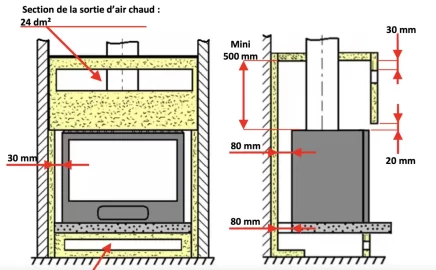

The installation plans clearly show a hot air exit above the insert.

If a blower is blowing into the chamber below the fireplace then it definitely needs an exit. Otherwise the blower will be spinning to fast and the hot air has no exit. However, it's impossible to know what they did in this particular installation and whether they followed directions unless there were pictures taken during the installation or you saw how it was installed.
I have exactly the same pictures in my booklet but I can't find the word turbo.
I too frowned upon the pictures, like it was installed wrong, they sealed it completely off.

That's sad. Was this installed in an all masonry surrounding? Do you know if there is an open cavity at the top of the fireplace as shown?
Yes all masonry, some space above but I cant really remember how much. It did or still has the metal /-\ thing inside above which you could close off, for sure the lid is gone now.
No cavity, the put some black paste to seal it off completely.
Have they done a bad job? Maybe even dangerous?
I trusted them but now I think they went for a quick buck.
It doesn't sound like they knew this model or read the directions. It may need to be uninstalled and then reinstalled per directions.

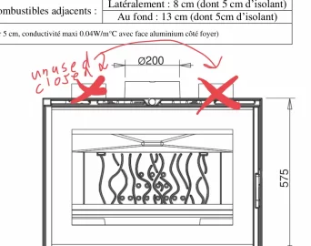

Now that i read your previous message again about the blowing, the 2 wide holes on the top are unused/closed. It only vents at the front. Through the stove vent holes.
That those are closed when you buy it makes me wonder if is not suited to run this way?

I don't know the unit well enough. A guess would be that because the output of the fans is blocked off, they are freewheeling and spinning much too fast. Normally this style of axial fan is very quiet. Without the top vents open, there is no convective airflow path, even with the fans off. The installation sounds like it was installed as a fireplace and not a heater.
