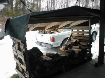

SPED said:
Cool, pallets are definitely the way to go in my book. My first year I had a really elaborate setup consisting of cinder blocks with deck boards on top and fence poles on the sides, what a hassle. I picked up some pallets on friday as well, the beverage mart near me seems to be overloaded with them lately. I may try and make sides out of them as well instead of the poles. Probably gonna be a lot of trial and error there....
Works great on sides also ;)

Cool, that's the plan then, I like sides that are free ;)
Hey guys, thanks for all the replies.
Yeah, I really like that pallet woodshed.
I think I'll build one next weekend. Can anyone else post photos of their wood shed?
Started my pallet wood holder today, won't call it a shed yet ;) Stacked a face cord(1/3 for all you sticklers) while I was out there. I can't wait to get my moisture meter, cuz I swear this stuff must have been down a lil while. Maybe it's wishful thinking but this stuff is a lot lighter than the last green load I got and so far it's all red oak.
