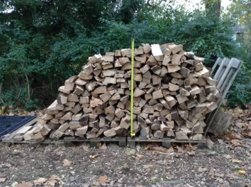

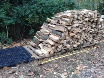

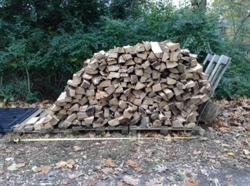

The ruler in the first photo is 8 feet long. The ruler in the last photo shows how high 4 feet is. The depth of the pile is 4 feet. The pile was delivered in a 12x6x2 ft trailer.

A little shy! About .80 of a cord.
Well short.
So we assume the splits are 16"?
He said pile was 4' deep. Not quite 4' tall and not a full 8' long.
Yeah so 3 rows @ 16" is 4'.
If the splits are longer, the 3 rows do not need to be 4x8'
Reactions: TreePointer
About a facecord is missing. About a 1/3. If I was stacking for myself. If you can straighten out the right end it will be easier to tell.
Nope, not a cord. Maybe about ¾ cord. Rick
If the splits are 18" then you would only need three rows @ 3.5x8'
Well sorry to see you are short. IDE stack the two rear rows 4x8' and see how much of a face cord you are missing.

2/3 cord by my reckoning. And yes, I'm from the Great State of Michigan, but I know what a true full cord means!
(I understand there is a belief out there that Michiganders see a face cord, and call it a full cord, unfortunate, but apparently true).
4*4*8 or 128 cu ft to be exact.
I would estimate that if you restack that all criss-crossed like the pilgrims used to do you might get it to "fill" a 4x4x8 foot box, but it would be getting really good airflow through there.
I would estimate that at 75cf of wood. If it is dry enough and the price was OK I wouldn't be afraid to buy another "cord" of it.
Looks like about 3/4 of a cord.

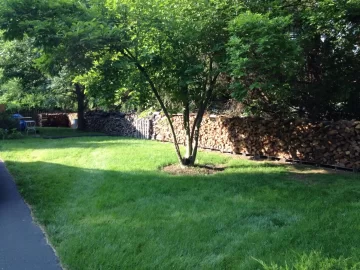

When I buy wood I have it delivered and stacked on pallets. I bought 8 cord delivered and stacked last spring. Guys brought primo red oak, white oak, black locust and a little bit of maple and Osage. They did a beautiful job stacking it on the pallets.
Problem was that when measured it only came to 6.5 cord, measured generously. Called the manager I bought from who told me the delivery guys were sure there was 8 cord delivered and stacked. I texted her some pics showing the delivered wood to be 6.5 cord. I paid for 6.5 cord.

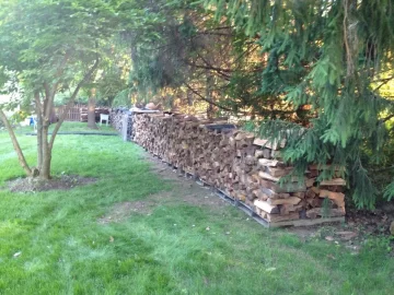

Sitting on about 13 cord in all, give or take. This is about 3 years worth for me. I'll replace what I burn this winter next spring with some ash and oak plus locust if avail. Lots of oak and ash here in people's republik of central jersey.
Welcome to the forum. Get as much wood cut, split and stacked off the ground and top covered as you have room to store. You can never have too much and it's like money in the bank.
As others have said, three years ahead is the place to be.
