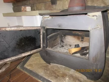

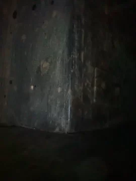

Hi
This stove has no markings, no labels. After searching for a very long time online I deducted that it is likely a Blaze King
I contacted a BK dealer who thinks it is an older Blaze King Princess... about 30-40 years old.
The dealer says they talked to Blaze King after I sent photos (posted here) to them.

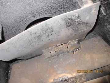

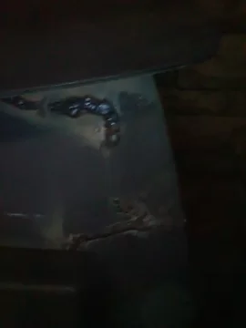

The result of the inquiries is not good.. Since the cracks were recently welded up without consulting the BK dealer, the stove is no longer 'certified'.
note -there is no identification or label on it, so we could not have consulted with Blaze King in advance.
This stove is to be my primary heat source, at least for now. I need your help.
I need your help (truly) to:
1. identify the specific model and locate the manual
2. figure out what parts are missing/not included and how to fix/replace/locate
3. figure out why the fire goes out whenever the door is shut. It only works with the door cracked open.
4. find out if there is a way to 're-certify' the stove (with Blaze King ?) if possible
5. Figure out how to use it properly and safely asap, as it is my primary heat source.
6. Share any other thoughts, comments, suggestions and encouragement that you want to share
Other questions:
How do we go about getting the stove re-certified before getting a WETT inspection?
Is there a specific Blaze King inspection or application process?
What does 'certified' actually mean?

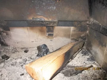

Current Problem:

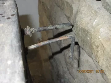

I've tried all the combinations I can think of with the knobs/sticks (see description) to try to make a 'damper' effect.
Nothing works. The fire always goes out after the door is shut for more than 2-5 minutes. I need to do what I can to ensure it works well and is safe, esp. using the vents/dampers properly. Thanks in advance for your ideas and suggestions.
Description:

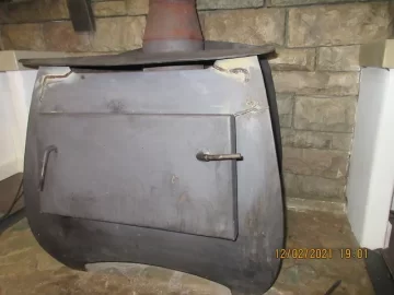

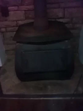

The stove is big, curved and squat, with no identification or label on it
It took me hours of searching online for 'old wood stove, four legs' and many other search parameters before I found anything even vaguely like this stove. I can't find anything more online. It appears to be one of a kind. Note it does not have BK side
I'll have to keep researching on my own.
For now, I'm not lighting it because I don't like leaving the door cracked open all the time, esp. if I have to leave the cabin for a few min/hours.
Written Description
There are four short legs, with no grate and no glass. I've seen on line, this stove does not have any side plates or a front plate.
It has two large intake holes at the back - one on each side, near the bottom.
There are two small holes in the door, where perhaps a plate once hung.

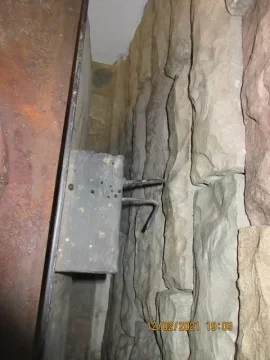

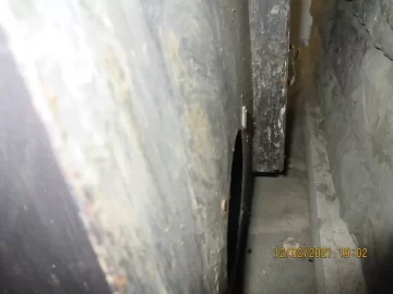

There's a centred, long, rectangular box, running top-down along the back centre, with two controls on the top (rear)
There are a few subsections to it...see photos.
I can't get at it - the stove is too close to the bricks (about 6") to get a good lock or to access.
One control is a knob that turns in a bit of rotation.
It sort of feels like a damper would feel like, but I'm completely guessing.
It is on the top right side of the box (if you are looking at the stove from behind).
The other control is a straight stick that is on the left, adjacent to the aforementioned knob.
It is shaped a bit like an alan key, i.e. it has a curved end that can be turned through appr. a 180 degree rotation.
It is close to the other control so I can't figure out if it rotates any further than 180.
That's because it hits the other control stick/knob at that if I turn it clockwise.

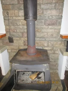

I don't think it can be re- UL certified. Meaning you'll have to use clearances for unlisted stoves. IF it is even legal to install this in your locality...
Reactions: clennox
Just to clarify for others reading, I've never heard of 'winsock' location, but "WETT inspection" has Canadian fingerprints all over it, so normal US laws/regs may not apply.
With that said, at least in the US, seems like plenty of people do some touch-up welding on stoves. I've never heard of 're' certifying. So not sure who is telling you that, and might not hurt to get a second opinion there... but again, Canada, so maybe that is a thing.
The fact that the stove has no nameplate means it would typically be treated as an uncertified appliance, with installation rules to match. Not really sure how you'd go about changing that...especially with a stove of that age.

I think the controls at the back might affect the draft.

House:
Single Story building
Roof pitch... climb over 12" goes from 78" to 84" (6")
Type of roof - metal sheets
Ceiling is sloped -probably the same climb
Stove is against an outside wall, with stovepipe up through the ceiling
Stove pipe and chimney are straight - no elbows or curves.
I don't know if there is insulation up there..probably a little bit. There's no attic/access from the inside.
Clearance:

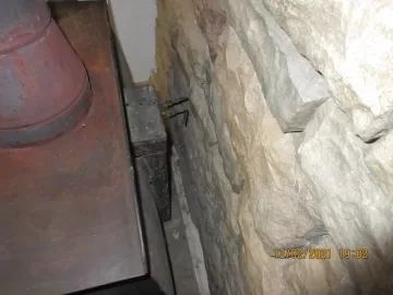

- rear ( to bricks/blocks ) 6"
- side 10" to wooden legs of bench/table horizontally and 18" diagonally one side and about double on the other side

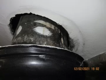

Stove pipe size
- insulated portion (?) with collar 30" circumference
- lower pipe 20" circumference
hole size
- 7"? 8?
I don't know how to remove the pipe to look inside the top of the stove.
Stove & Stove Pipe:
- Floor to ceiling height 6'6" up to 7' (angle, round collar/ring over the insulated portion. no ''box' enclosure)
- Insulated stovepipe app 23" to the (sloped) ceiling. It looks like it continues up but the measuring tape doesn't fit in the hole. Given that there are dents in the insulated portion of the stovepipe, I think there may have been past chimney fires due to high heat (lumber is provided for fuel vs. logs).
- Height of unit 27.5"
Chimney & Flue
- chimney height - unknown - looks like maybe 3' to 4'? I'm too chicken to climb up onto the roof to measure, as there's no way to gri
- flue height - unknown and I don't know how to evaluate/measure
- cap was missing when I moved in, so the landlord had a friend put a flattish one on, held down with a rock for now.

What is behind the brick? If studs, you're too close (for an unlisted stove - no tag = "not listed", even if it had a tag before).

Hi

Current Problem:
Description:
Written Description
View attachment 286853 View attachment 286854 View attachment 286855 View attachment 286856 View attachment 286857 View attachment 286858

That sir is not one of our stoves. I agree, some kid built that in shop at school or a guy should have let his kid build it!
Reactions: clennox
Child labor :p
Reactions: clennox
It is all I've got. The guy who lived here a few years ago 'got it from somewhere' as per my landlord.
How do I make it safe and functional?
The chimney doesn't go above the roofline. That affects draft, true? What do I need to do?
the front door has 4 holes in it which likely held a plate/id on it. The back has two large intake holes and the front has the outlflow (?) at the top (open area).
I know very little, but it looks like it is a decommissioned and modified Blaze King.
That's one of those cases where it's going to be cheaper to replace that stove instead of trying to do any repair work or modifications to it. No matter how much work you put into it it will never be UL certified. I'm not sure about BC, but in Alberta it's almost impossible to find an insurance company that will cover a non UL listed stove.
See what's out there for used stoves and start there. Kijiji, facebook, etc.

"never" is too strong a word.
But it is likely that draft is negatively affected because when wind curls over the ridge of the roof and may "push" air down into the chimney. Depends on local geometry, wind direction etc.
That could also push CO (kills) into the home.
Also I think it could be unsafe in another way; you don't want hot exhaust, and in a worst case scenario embers, blowing against a roof. (I don't know how serious this last thing is in practice.)

"That could also push CO (kills) into the home."
I keep a window open a crack when the fire is going, and there are CO2 and CO detectors. The latter is placed near the floor, as CO goes downwards. It is also there as monitoring for the RV propane cookstove (no vent) and oven...another reason to keep the window cracked (and the bathroom exhaust fan going).
Ok. Embers are unlikely anyway. But draft issues are not. Alarms are good, needed, but they don't prevent danger.
