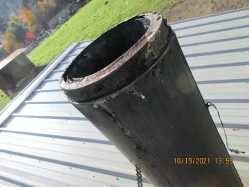

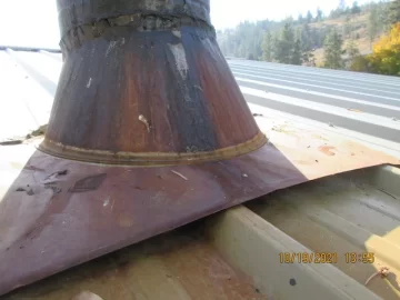

Thats great but I am going to bet he won't do a thing about the chimney. How tall is the chimney overall?
Reactions: clennox
Type of roof - metal sheet
Floor to ceiling height 6'6"
I'm pretty sure the chimney does not go up as high as the roofline.
It looks to be about 3'?
Here are some photos.
The chimney is behind the tree - about 3' away.
When I first got here, there were branches brushing up right against the chimney.
They've been cut back to about 3' clearance.
The tree is on the neighbouring property and I haven't worked up the nerve to approach them.
LL says don't bring it up as there's some kind of long-term boundary dispute.
I understand there is some kind of cap that can direct the direction of the smoke?

I doubt you have enough chimney height to make any modern stove work properly. There simply won't be enough draft.
Yes, a short chimney can easily result in a smokey interior; it does not"suck" enough - the draft being established by the fact that warm air wants to rise in the chimney and that rising is amplified by a taller chimney.
A better (safer) stove may solve only half of the problem.
You don't need to be skilled in metal works for that. Buy proper (UL listed) system components, and it's essentially plug and play.
yes..the chimney will have to be replaced by my LL is really good at metal works etc.
You will need atleast 12' of total height. Maybe 15 the stove should have the specs
