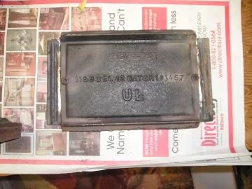

Is this Jotul 118B worth fixing?

Here’s an update on my re-build. I took BG’s advice and removed the rest of the top half.
I tried liquid wrench on the 4 bolts for week and when I tried to remove them I used heat and they still snapped. Drilled and re-taped with no problem.
I got lucky and was able to get the 2 ul side burn plates for $220. Delivered.
I should get the bottom burn plate next week. I ‘m lucky enough to a friend in our weld shop at work so he just did the front top plate for me. I have the top plate lower in the shop to get welded and should have that next week.
