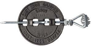

You are running very hot on the stove top. That is overfire temperature. I would consider adding a key damper to the stovepipe to slow down the draft.

BeGreen, Thank you for the idea of a damper. My problem with them is that if I have an overfire and close the damper that fire isn't going to go out before it tries to go the other way and tries to enter my home.

Why is the damper a concern? I have never seen that happen. Have you?
Do a leak test with a flame, cigarette or incense stick. Move it around slowly by all the seams in the stove. Some leaks are pretty easy to fix with just a little stove cement.
js156 I don't understand this statement;
My problem with them is that if I have an overfire and close the damper that fire isn't going to go out before it goes the other way and tries to enter my home.
The damper is only meant to be closed partially to slow draft before the stove runs away.
And the damper can never be completely closed. that is why there are holes in the middle of it.
[Hearth.com] Isle Royale - Difficult to control the burn.
It's better to have the damper before the fire instead of after it.
If I have an overfire, I need to choke it out, (before the fire) not after it! (chimney key damper)
