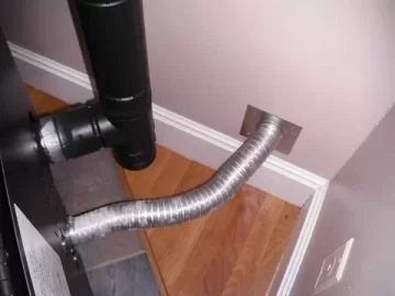

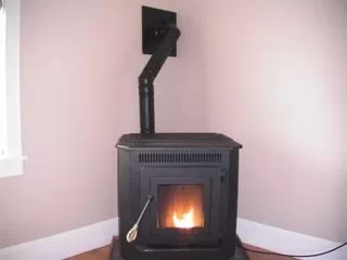

Looking at the interior pics of your stove, I think you should check your installation manual. I believe that when these stoves are installed with an interior T, like you have, the fire protection on the floor needs to extend under the T. Looks like yours is shorter than that.
Just in case there's ever a problem...
Jim

Lobstah said:
One other off-topic note...
Jim
The clean out tee is half way over the wood floor. I'm not worried, what could happen?
What could happen is your clean out tee could come loose, or someone not familiar with it could take it off, and deposit some glowing embers on your floor. Over the years it could come loose on it's own and do the same thing.
The larger problem would be that if there was a fire, and your stove installation didn't adhere to code, then it would be a pretty large amount of ass-ache for you.
Your stove and your house though...just trying to be helpful.
Jim
Thanks Lobstah for your concern, I really didn't think of it that way. I may do something different for the corner. Maybe a hearth pad that fits flush in the corner.
I know I have a piece of leftover tile in the basement somewhere, I'll make sure I put a 12 x12 under it until I can figure out something else. Thanks again Lobstah.

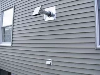

Sydney, how close are those windows to the vent pipe on the outside of your house?
That vent must be more than 4 feet from any window or door that can be opened.
In addition is that window air tight when closed?
Hi Smokey,
Vent is 4 ft. from window on the right side and 5-6 feet from the window on the left side. I think the outside pic is deceiving. Since I posted this question, no more smell in the house. The smell happened on that really windy night, I bet you remember. Thanks for your concern.
Glad that you no longer have the smell.
It shouldn't have occurred even on that particular day. Yep, it sure was a wild one. A couple dozen more like it and I'll be able to fish off my deck.
If those windows aren't air tight the exhaust vent just might be close enough for the gale to have pushed some smoke into the house from out side, likewise if your OAK was not completely sealed it could come in around that (since it is in direct line with your exhaust vent). It would likely take the wind blowing directly into that wall for that to occur.
