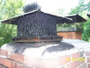

up date went up on the roof today and yes begreen the cap was clogged up.so i cleaned the cap and the chimney again,which was not that dirty.I will fire it up tonight and will get back,and will keep a check on that cap for now on thanks ill get back steve...thanks begreen,and everyone who replied i will get back.people on here are very helpful its time to get up on that roof and remove that cap n clean it and go from there thanks..
Problems with smoking this time of year are almost always caused by a clogged chimney cap. Can you see the cap from the ground?
Jup date went up on the roof today and yes begreen the cap was clogged up.so i cleaned the cap and the chimney again,which was not that dirty.I will fire it up tonight and will get back,and will keep a check on that cap for now on thanks ill get back steve...
Even the larger screens are clogging up this year! I just went to a Kozy 231 with a clogged cap, flue was pretty clean. It's a strange year!If the cap screen has smaller diameter openings, consider replacing the screen with larger openings.
I know some of yous guys like to remove the screen. I just can't get myself to do it. I just replaced my rotted one, with new. I have not had any problems with cloggage. well except for the first year with not so dry wood.Even the larger screens are clogging up this year! I just went to a Kozy 231 with a clogged cap, flue was pretty clean. It's a strange year!
i put the screen on about two years ago, because a bird came down chimney and was stuck in my stove. wife was going nuts..i used a piece of stucco sreen to make it about quarter inch holes.ill just check on it more often, now that im aware of problem. going to fire it up about a hour thanks..I think you will find Oslo will be burning well now. Good to hear it was just the cap. If legal, you might want to consider removing the cap screen for the winter and put it back in for spring/summer to keep the birds out.
There's your problem. The holes must be a minimum of 3/8" by code, still not enough though. 3/4" is best, it's standard on most liner caps but not on class A caps.i put the screen on about two years ago, because a bird came down chimney and was stuck in my stove. wife was going nuts..i used a piece of stucco sreen to make it about quarter inch holes.ill just check on it more often, now that im aware of problem. going to fire it up about a hour thanks..
you all will be happy to know that oslo is back and working like a charm.thanks webb you were the first to tell me the problem.and im going to do some roof maint. in the spring going to look into getting a bigger screen.i want to let everyone know thanks for the tips. keep burning baby......There's your problem. The holes must be a minimum of 3/8" by code, still not enough though. 3/4" is best, it's standard on most liner caps but not on class A caps.
