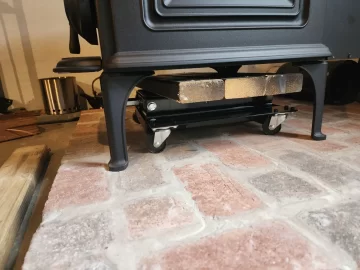

So the sweep that did the cleaning this year did not have a staircat. I got this wheely jack to try to get the stove into place. It is already on the hearthpad but getting the flue collar into the thimble is like wrestling a hibernating bear. Wish me luck, hah .

Well, the wheely dolly worked like a charm. Highly recommend for anyone moving a stove on a flatish surface. I could basically do it one handed. I am a little concerned about the level of the connector though.. the hearthpad may have been a little too high afterall. What do you guys think? Its 12in to the wall.

Is the dolly still under the back legs?
