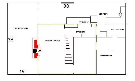

Maybe this floor plan will help:
The center section is the size of the second floor (in yellow). The firplace passthrough is approx. where the # 24 appear on the left side of that section.
Note image and text edited for clarity... twice...

I'll again have to defer the sizing of the stove issue to the real pros on here, but my guess is, if the rooms in your layout all have standard door openings, then it may be tough to expect a stove of any size to be able to circulate enough heat throughout the whole house. That room by itself is 672 square feet, and if its somewhat closed off.... then maybe the Phoenix is too big???
If the second floor is above that room.... maybe (2nd)floor registers to let the heat get upstairs???

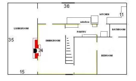

I have updated the floor plan in the attachment and above to show the masonary and hearth in red, the stove proposed location in black, and a rough layout of the rooms.
The first floor is approx 1850 sf. the second floor (yellow outline) is approx. 575 sf. Yellow lines also indicate brick wall on the first floor.
I am drawn to the Isle Royale because 1. it's hearth legs make it one of the largest stoves able to partly recess into my existing fireplace, and 2. because it's good warranty and relative simplicity make it partly imune to my 'rookie burner' status.
I will post back the fireplace dimensions when I gather them. There is a functional majestic damper on the diningroom side and a broken one on the livingroom side which will be removed. Then a horizontal stove pipe to a cleanout and up to the liner should be 'straight forward', I would guess. I would also need to do 15" or less of non-combustable flooring in front of the hearth depending on the stoves final position. The chimney is approx 20' from the damper to the top course of brick.

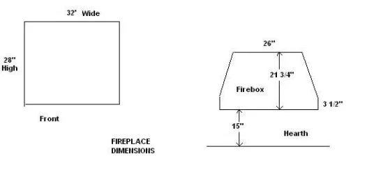

The only real problem the Heritage presents me then is that it's height (29") and or width (29 1/2") cause me to move it completely outside of the existing fireplace and make more room altering additions to the hearth pad on either side of the fireplace. I will definatly look over the Phoenix... in person before commiting to either.
Ahhh..yes if it wont fit then it wont fit. The hearth legs on the quad reduce it to 27" A few things to consider on the isle royal, 1) access to the damper bypass lever, 2) top load access, the double front doors can be a PITA to load and close. If you have to use the front load, single doors are typicaly easier to deal with. It bothers some and not others, just something to think about.

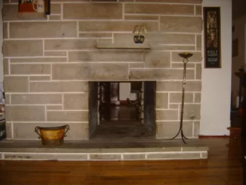

As promised; here are a picture and the fireplace dimensions.
Thanks again for all the great help so far.
