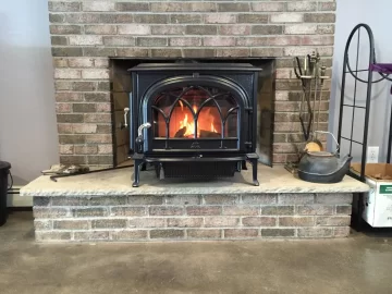

Got it in today, just started my first break in burn.
  • [Hearth.com] Jotul F500 replacing VC Defiant
Nice looking setup!
Reactions: claydogg84
Looks really nice, I love the fact that it's raised up off the floor that'll make side door loading really easy.
