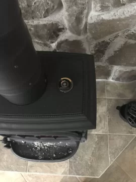

Here's what the lower level of my home looks like- just over 1,200 sqft 80% finished space with new windows, insulation, drywall etc. However, the flooring in the lower level is all stone tile and the unfinished space (20% of the lower level) is foundation cement wall and cement floor, there is also a large staircase in the same room as the stove. I am assuming that the stove is struggling to heat because of the cold floor and walls in the basement, and the loss of heat up the stairs. I am struggling to get the thermometer in the basement where the stove is located to exceed 67 degree F running the stove at a consistent 500+ degrees F, even in weather in the 30's (not very cold for Jan-Mar in NH).

Since no one has asked - Where are you measuring the temperature of 500 on the stove?
[Hearth.com] Jotul F500- Will it do the job?
Right where Jotul recommends measuring it; right or left side between the top mounted stove pipe and edge of stove.
