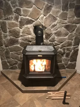

I bit the bullet...

How's it heating for you?
What is the stove venting into? Is there an insulated wall thimble?
Not sure if that's the place for the thermometer. Might want to put it on the stove itself if it's like my thermometer.
Manual says you can run it using the flue temp, and that the thermometer will react faster to changes if it's on the pipe. I use mostly flue temp to run my little Keystone. I can light off the cat with the stove top well below the recommended 250*, if I get the flue temp to X degrees for X amount of time. But the OP appears to have double-wall pipe there, so I'm not sure how well that will work...lower temps will be seen than they indicate in the manual. (broken link removed to http://woodstove.com/images/editorial_support/ProgressManual/operation.pdf)
I had three thermometers on the stove; one of the soap stone, one of the cast iron near the flu and one ok the stack. I've removed all but one, and use the temp on the one next to the stack on the cast iron. So far it's been burning very well, and I haven't had to use any other heat source in the house in 3 weeks. However, I recently started having a back puffing issue and a strong smell of smoke in the house... I think the combusted might need to be cleaned..
Better take a look at the flu. Check the cap specifically. If the condition (back puffing) has developed over the coarse of a few weeks I would be questioning your wood moisture content. Any chance you got into some wetter wood? Chances of a plugged combuster are very slim.
Cleaned the combuster, was not at all dirty. Wood I'm burning is the same I've been burning for the past month; all delivered in one load. The chimney was cleaned and has only been burned in since i installed the stove, so I don't think it's clogged. The smoke is coming out stressing from the stack...
Good to hear the cat was fine. Still no real idea what the moisture content of the wood is? All things considered. Not much, other than your wood that will make smoke;) Easy enough to verify how cured your supply is. Grab a moisture meter at almost any box store or likely any good hardware outlet. You may be surprised at what it tells you. Food for thought.
