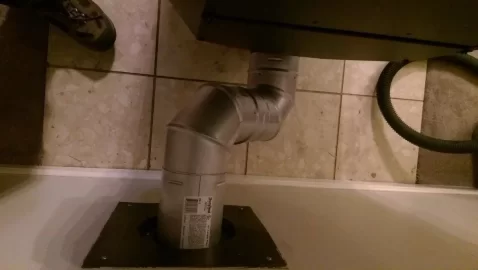

Here is a shot of what the pipe situation is in the back.

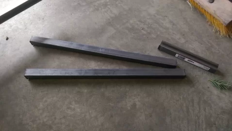

Here is a shot of the square tubing. I will cut it to size, weld it on the corners, seal up the ends, grind it and paint it.

Just for future reference, in case someone else in need of help looks at this thread; NO, it is not okay to have a joint in the thimble - silconed or not, plain not okay..

I just wanted to say, you can run an OAK without changing that thimble by putting in a smaller separate one. You seem good at fabrication, you could probably fabricate one if need be ( I would).

I really would have liked to go straight out the back of the stove with a new thimble and reduce the distance the stove is from the wall from 12" to 2" but I now believe that there is a stud directly behind the stove which will eliminate that as a possibility. :(

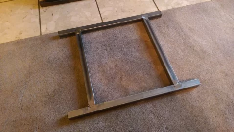

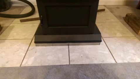

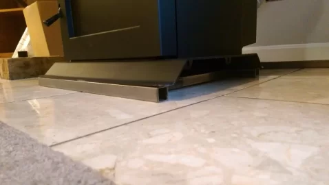

I picked up some 16 gauge square pipe mild steel and some primer and paint. I got the 4 pieces welded up and because of the lighter gauge steel an the fact I don't have a jig for this setup the frame I made bowed a little bit. But in testing it appears to have worked. The weight of the stove is enough to straighten things out. I just hope when I turn this on for the first time that there is not major vibration of some kind!
Just primed it and will paint it in about an hour or so. Hope that the paint dries quickly so I can get this thing rigged up tonight and the pipes glued up.
Here are a couple of shots.

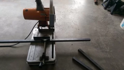

Cutting the metal.

Before I placed it under the stove. No paint yet.
[Hearth.com] Just purchased a new P68 to replace our Earth Stove

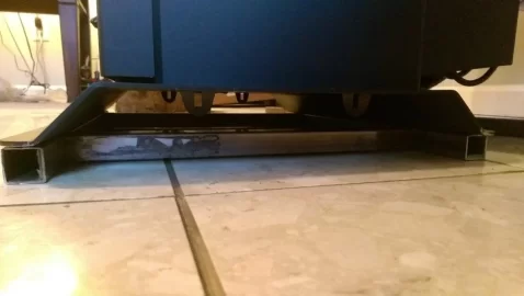

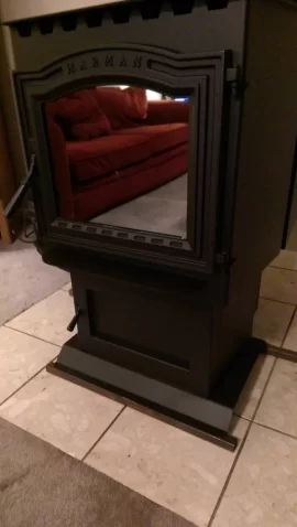

Inserted under the stove.

I doubt seriously you will get any vibrations because the heavy tank will hold things down very well. Especially if you tack the square tubing.
Just painted the riser. I am chomping at the bit to get this stove going! It's cold outside! LOL
So, once this paint dries I will slide it under the stove and set the two screws that I drilled for that will attach to the bottom of stove. Then I will position the stove so that the Pipe is all lined up and then I will start silicone the outside joint into the T. Then the wall thimble itself on the inside and outside. At that point I may continue on and get the rest of the pipes inside glued up and then fire the stove up. Might not be until midnight though so it may have to wait til tomorrow. I should probably let the paint dry longer then 3 or 4 hours before I put it under the stove. Tomorrow we're in the 20s for highs.

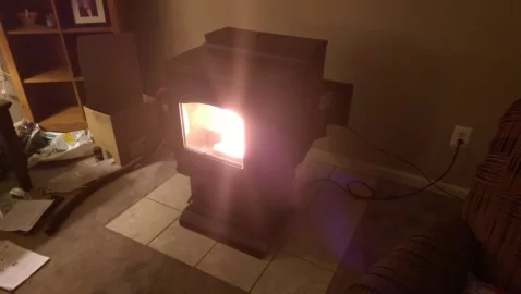

Stove is operating! Burning off some serious manufacturing stuff at the moment.
I have the feed rate set at 4 and the room temp set at 75 and the flame is super huge.
What are good settings for a newbie. The only way I can get the feed to slow is if I turn the room temp all the way down to 50.

Holy cow that was some serious flames and heat! Until I figure this room temp thing out I switched it over to manual mode feed rate of 3 with setting of 3. Going to let it run on this setting the rest of the night.
So far no leaks at the joints which is a good thing!

In room temp mode you need the room temp probe on the stove for one thing and placed about 3-4ft off the floor. A lot of us Harman folk attach it to the back of the stove in a coil with the probe itself sticking out to the side slightly, say two to three inches. Back there it will pick up room air returning to the distribution fan. But all that said, you will get a big flame if the stove is trying to make up heat in the room, the larger the differential of your setting compared with room temperature the longer and ultimately larger the large flame will occur. It will eventually cut itself back as the ESP is satisfied and as room temp gets closer to your setting. Stove temp ( or so called "constant burn") works solely on satisfying the ESP. Once your house stabilizes in temp, I think you will find Room Temp Auto ignition to use less pellets than Stove temp/constant burn ( depends how tight your house is). Your current setting of 3 and feed rate 3 probably correlates to about a two bag day with a p68 ( 24 hours) but it will be consistently that day in and day out.
A feed rate of 3-4 is normal and unlikely that you could tell much difference. Feed rate on a Harman is the most misunderstood control on this entire forum ! Read the sticky note article on what your Harman manual doesn't tell you, to learn more about Harman feed rate , it's at the top of the forum pages.
P series Harmans are not the quietest stoves on the market, fwiw. They are reliable, "heat machines" and easy to clean though. Being all steel they echo more sounds than cast iron might but they also radiate some heat as well as blow it out.
As soon as is reasonable for you, get that stove plugged into a surge protector.
Good luck and I hope it serves you well ! It will take you a while to learn the controls but the more you understand that Harman stoves kind of run their own coarse, the easier it will be for you. So many come in here as new Harman users and try to over ride the controls. Really they just ask you to feed them and keep them clean LOL.
