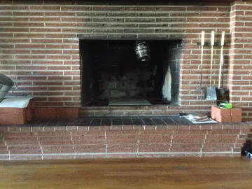

Here's a photo of the chimney liner... Now waiting for more parts (30 degree elbow) and stove lifting assistance <>

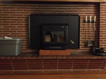

Here's the finished install -
[Hearth.com] Just Purchased Summers Heat 50-SNC13i...
Looking good and almost ready for fire. It'll need a proper hearth extension or hearth pad first.
Reactions: Oldhippie
I currently have approximately 12" from stove body surface to hearth brick edge and then a 14" drop to the floor surface. The line distance from stove to floor is 35+". I wasn't going to add anything...
That's a nice floor. It would be a shame to start adding burn marks from popped embers and perhaps an occasional log roll out. Yes, this does happen. I can see not going with the full hearth protection requirement because of the height, but to not have ember protection is risky business.
Hearth Extension
The firebox on your insert will extend out eight inches (8”) from the face of the fireplace, so you will need at least sixteen inches (16”) in front of the door. If you do not have this, it will require you to place an approved floor protector in front of the stove (such as a hearth extender shield).
That's a nice floor. It would be a shame to start adding burn marks from popped embers and perhaps an occasional log roll out. Yes, this does happen. I can see not going with the full hearth protection requirement, but to not have ember protection is risky business.
You speak the truth...! I'll look into a removable hearth pad for the flying ember potential. Thank you!!!

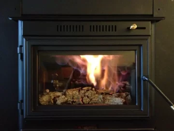

Here's an image of first fire Saturday September 21st. Secondary combustion with Ash logs...
