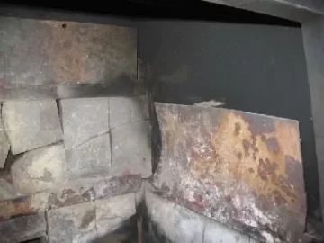

a few more pics of the current state of fire bricks

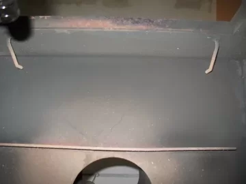

well i was messing around looking at the firebricks to replace them in my stove and i noticed 2 hooks on the inside of the front face of the stove! what the heck are they for do you think? i was thinking liek a fireplace mesh curtain but i dont know, that why im asking the ? here to you experts.
heres some pics

Well that looks a lot better with the inside cleaned up. I think I recall some kings had a sheet steel plate that hung from those hooks, it hung down into the doorway a few inches and swung back if you were adding a large piece of wood. I guess it was a shield to protect the top of the door from extreme heat. Judging by the earlier pictures you showed of the interior, this plate was removed and the previous owner liked to hammer in pieces of wood too large to fit. That would explain the bent baffles and broken firebrick.
You might find part of the door frame on the stove body is cracked, often happened when the stove is overfired, as yours shows evidence of. Be sure to replace the door gasket with the proper 7/8 inch glass rope and check that it still seals properly, if you expect to control the fire. If it won't seal with a new gasket, you have a major problem on your hands.
The older models (pre-combustor) ,were fairly inefficient, mainly offering the luxury of an automatic damper, but since the heat goes straight up the chimney without much chance to be transfered to the stove body, it is tempting to turn the thermostat all the way up to get some useful heat.
If you want to know the date of manufacture, it is usually shown on the very bottom of the metallic sticker on the back of the stove.
If you decide to keep it, and want to dress it up, you might check ebay for the ceramic insets, which were available in various colors (kings and princess used different sizes) Some older B-K dealers may have some still sitting on the shelves.

ok im starting to remove the fire bricks to replace them with new ones, do these things get cemented in or what? some were a little stuck but i think that was just from ash and rust..
Ray
also where you guys picking up firebricks any cheap place?
help please. i appreciate it. :)
You probably don't have a Menards up there, that's where I bought some cheap. What about a local mason yard?
