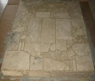

well i got the hearth it sits on pretty much done.. but was grouting it today and realized that i was using epoxy grout! i hope this isnt goign to be a problem, i researched on google and it was saying it isnt flamable. so lets hope so. it was just left over grout we had for a kitchen floor.
Ray
heres a pic of before the grouting and after, man smashing up all them little pieces of tavertine 3/8" tile to fit all over the top was pretty fun
