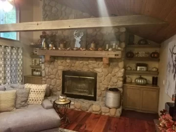

Forgot to attach a pic in the original post so here is one. I must have missed that part in the manual, where does it say that at? And even if the insert going in is ZC rated?

It doesn't say no inserts but it does say no accessories or components not listed for the fireplace. And there are no inserts listed.
And no you need both the insert and fireplace manufactures to approve it.
