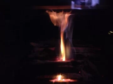

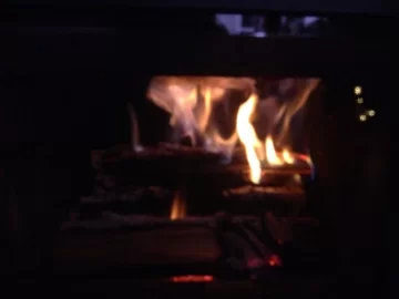

Ok so here is my promised time study. I have a Madison, with 5'2" of double wall up to ceiling, then class A from there, 10' of it. I have no problems with smoke pouring out of the stove when it is open, unless it's a VERY windy day, and on a cold start.
This is yesterday evenings burn and then some info from this morning when I got up. This is loading 6 4-6" splits, so 2/3 full firebox, avg % moisture ~20
10:44pm- 150 degree stovetop, some hot coals that I raked forward and loaded up the stove and used bellows to blow on coals for 3 minutes, door all the way open..
10:49pm- 147 stovetop, good amount of flames, especialy between wood and fiber board. Shut door to just cracked open.
10:52pm- 153 stovetop, secondaries going strong, most of wood covered in flames.
10:55pm- 175 stovetop and what moisture that was coming from end of splits is drying.
10:56pm- 205 stovetop, Shut door all the way-wood flames slow/die, secondaries almost completely take over.
10:59pm- 280/350 stovetop, (Left/Right as looking at stove)
11:01pm- 350/435 stovetop, very active secondaries at this point, I close air down 50%
11:03pm- 425/500 stovetop
11:06pm- 552/520 stovetop- I shut air all the way, only secondaries now, stack temp 300 at stove/base, 230 at ceiling (outside IR reading, double wall pipe)
11:08pm- 540/540 stovetop
11:11pm- 487/508 stovetop, firebox has went black/all flames/secondaries gone, temps dropping, I reopen air all the way.
11:13pm- 443/443 stovetop, whole firebox suddenly erupts in massive flames.
11:16pm- 550/585 stovetop
11:16pm- 575/616 stovetop (yes, same minute as previous measurement) Closed air again.
11:17pm- 628/650 stovetop, no flames from wood, only on top-secondaries going like crazy. Stack temp 341 at base, 237 at ceiling.
11:22pm- 575/600 stovetop, medium secondaries only.
11:27pm- 500/509 stovetop, it has reached was I consider 'cruising secondary action'
11:38pm- 580/560 stovetop, still cruising nicely
11:51pm- 580/592 stovetop, cruising great, stack temp 265 base, 213 at ceiling
12:09am- 640/580 stovetop, cruising
12:13am- 591/560 stovetop, great cruising, secondaries only still, Time for bed, goodnight!
This morning:
6:20am- 230/226 stovetop, just hot coals in the stove, rake forward and reload, about same amount of wood as last night. Flames start right up on wood, leave door all the way open.
6:30am- 264 stovetop, fire going great, so I shut door to only cracked open.
6:32am- 375/383 stovetop (Left/Right as looking at stove), I now close door fully air 100% open.
6:41am- 536/645 stovetop, close air all the way.
6:46am- 571/528 stovetop, fire has gone out again, I open air 100%
6:48am- 626/580 stovetop, firebox has suddenly been engulfed in flames again, temps rising, I close air all the way and know she will level off and cruise from there while I'm at work.
So there it is, all temps measured with IR gun, and this is now my standard procedure for the Madison. I don't think the AAS works anymore, I just adjust manually.
It does take longer to get going from a cold box, so I try to always reload between 150-250 stovetop as it's easier. The weird part about it to me is that as mentioned up top, the fire always dies out after I cut air all the way the first time, then I reopen air and 1-2 mins later its engulfed, and I can shut the air down all the way again after that and it'll cruise till it runs out of wood. Not sure why that is. Only for a few mins after reload is there any visible smoke from my chimney, this stove seems to burn very cleanly. I did have issues a little bit ago with getting stove up to temp, but that was with wood that was probably around 25%, give or take. This stove loves DRY wood. Any questions, feel free to ask. Thanks and I hope this helps other Madison owners. Overall I am pretty happy with the stove so far, it was definitely in my budget which was important to me.
