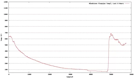

Yep I just watched it tonight when I fired it up cold ... During startup, the stovetop was maybe 50-150F hotter. Once it was cruising along there wasn't as much of a difference between that side-upper-corner and the stovetop, but I can imagine now that under "Gates of Hell" conditions the stovetop is probably going to be hotter than the side-upper-corner measurement point ESW is using for their reference. Oh well, that explains things. My old Jotul 8 would routinely push 700-750F on the center stovetop with good dry wood briquettes (wood brick fuel or liberty bricks) anyway.
As for flue temps.... here's a graph of my current burn, coming from a probe type thermocouple sitting ~4" inside the pipe, roughly 12" above the stovetop (at the horizontal end of my 90 degree elbow):
[Hearth.com] Learning the new Englander Madison
I have noticed that the IR temp gun temperature on the stovepipe does roughly correspond with 1/2 what that thermocouple probe is reading.
