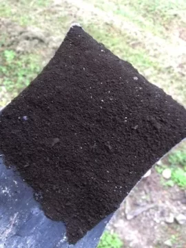

Congrats on the Madison. I like mine. I am still a little uncertain about the AAS system. Sometimes it works perfect. Other times it doesn't. I've found that if i pull it all the way out and set it, sometimes it will get stuck and not trip. So i pull it all the way out then bump it in, just a hair. The rest of the winter went good. The stove ran good really throws out the heat. I do have problems with marginal wood. But I'm going to for the next couple of winters, until my oak wood gets dry. I also figured out that my stove top thermo isn't reading right. It appears to read around 100* high. I have ordered a IR thermo for this winter. I swept the chimney pipe last week and got a little more than a quart of brown ash and very little creosote. I'm going to say my problems were ( not enough draft, marginal wood, inexperiance with EPA stoves, being overly cautious so as to avoid the dreaded run away, and stove top thermo being inaccurate.) So plz let me know how yours goes. I think this year will be much better.

this is what came out of the pipe
Thanks for the update. Every season will get better, especially with drier wood.
