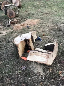

Is it okay to use the chainsaw with the grain?
Looks like you need a splitting maul and some good, large steel wedges to add to your arsenal. Some wood splits easily with an axe but there are times when heavy duty leverage works best. I have had to use 4 wedges on some big rounds. FWIW, I am not a big fan of the grenade style wedge. If it splits that easily let me have at it with the Fiskars.

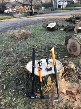

Splitting maul? What do you call that 8lb monster?

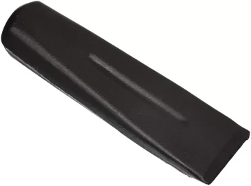

The grenade wedge kept popping OUT when I hit it with the fiskars or the 8lb maul. I’m not sure when or how to use that particular tool yet.
Those are pretty gnarly. Makes the green spruce I was splitting today seem like nothing in comparison. I drove a wedge all the way into a red spruce round and into the splitting stump before it let go. If I were in your shoes, I would try the really long splitting spikes. You can use it as a lever in addition to a wedge. I've never used one of those four sided wedges.
I've split some big fir rounds where I buried 2 wedges, had to flip the heavy sucker over and drive 2 more wedges in on the opposite side, then whack away with the maul.

I have the Fiskars 8 lb maul and it is a beast If the splitting side can't make it through, it works well as a sledge to push wedges. I too have a 4 lb hammer for setting the wedges in, or when the splitting axe won't work, but the maul is too much. You will never be sad for more quality tools. They will pay for themselves in time, especially when heating with wood.
I don't like those Grenades,The best grenades/wedges that I endorse are the Oregon Splitting Grenade.You can find them on ebay.Get two if you can.

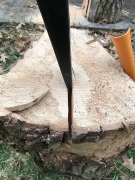

I don’t know if it’s me or this split. I just precut a 1” deep groove to seat the wedge. I can’t even get the wedge to the bottom of the groove. I can’t even get it to feel tight.
The wood feels made of concrete. It’s not budging at all to let the wedge in. I know I can saw it half through and then wedge it, but I feel I’m missing something technical here.

I finally was able to get it in with the 8lb maul. Seems like getting the right weight and velocity is tricky. Too little and you don’t go anywhere too much and it bounces in and out. Just right it wedges in just a bit deeper and let’s you take a bigger swing next time.
Those kind get personal real fast. Lol. Splitter is best, but if you work from the outside (sometimes chipping thin spits) eventually you can crack it all with a lot less headache. Glad to hear it didnt get the best of you.
