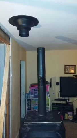

Here is where the stove is. I am still wondering if the bend angles should be just where the pipe exits the stove and enters the flue. I also was going to remove the damper ... but now I am wondering if a better choice would be to put it right at the point where the black pipe enters the flue. Then I could just pop the pin out for cleaning easily and remove the pipe.
So you've got better than 15' from the stove top to the top of the stack? That should work fine. It's better to have a straight rise out of the stove, with the bend at the top. I would take out that section of adjustable elbow (I don't like that stuff) and try to put two 45s up there instead of two 90s. It can be tough to get the lengths to match up though...
Yeah, I like having the damper at the bottom just above the stove top, where I can remove it easily, like you said. Another thing; Does the distance from the drywall meet the maker's required clearance to combustibles?
It's actually not that close...from the back corner of the stove to where the drywall starts is 14" which is the minimal clearance.
The only place there is a problem is right at the ceiling where you see that 2x6 beam I put up. Well the stove pipe adapter is single wall that goes into the flue and right at that spot it's a little closer to the beam than code will allow. Not sure how I am going to deal with this either as that is a part of the kit to install the flue.
