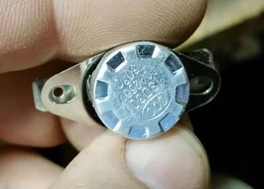

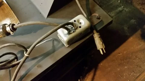

I installed a 50C (122F) normal open thermal switch ( couple bucks on ebay) in a 'handy box' to control the blower on my stove. Screwed the switch inside a blank cover wired it up to the cord. Then made a bracket to keep against the stove back. Temp goes above set point and the blower goes on. Drops back and it turns off. So its never on when the stove is cold.
