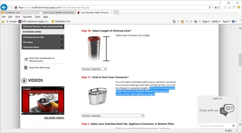

I thought liners were only shipped in 25' sections? maybe that's just if you order it online and do it yourself. if that is true though I would think there would be a union of sorts somewhere in there so it wouldn't be all 1 piece. probably not a big deal though. from the reading ive been doing on here that seems steep. I just joined about a month ago. been poking around reading for better part of year to prepare for my install. went in last weekend.
Liner can be much longer. Depending on the supplier, liner comes in 5 ft increments from 5' to 50'. This is Rockford's selection for Rock-Flex 316Ti .006 Stainless Steel Chimney Liners. Heavy Flex may have less options, but usually have at least 25-35'.

for some reason I swear when I was shopping I read they wouldn't ship more than 25'. sorry for any misinformation. i'll see if I can dig it up tomorrow. maybe it was just one place or something.

Northline Express sells Homesaver UltraPro liners in 15-35' lengths.
We get 150' rolls of liner in.

I knew I saw it somewhere. must be something about shipping ovalized?
