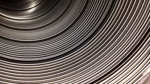

There are no arrows on this liner I just got. I looked up peoples posts talking about gills and direction it goes but they both look the exact same to me. Do they make S.S. flex liners that go either way?
Mine is a "M-Flex" liner which has no arrow painted on it. Pictures below are 1 from each end. I can't determine which is up and which is down.
Any help is appreciated.
Thanks,
Ryan
P.S. I looked for more threads like this on this forum but didn't find anything in my search results. Am I the only moron who can't figure this out? lol

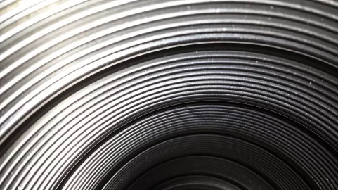

phone isn't letting me upload 2 images on one post

most liners do not have a direction that they need to installed in there is no top and bottom to the liner
