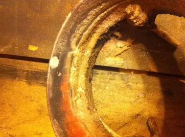

Correct. But for the flue fire to have consumed all the evidence it would have to of been burning inside the top of the stove and the first few inches of the flue as well as the next several feet as there is no creosote anywhere.
flue collar showing the fluffy ash that is in the liner and everywhere else in the stove. The two bolts holding it down must have stretched a lot, I had it down snug last November but they were very loose just now.

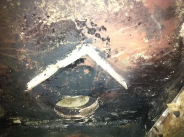

Top of the firebox. I did vacuum the ash off so I didn't get it in my eyes when I stuck my head in there, otherwise it is untouched.
I have an insulation blanket on top of the stove to keep the radiant heat off of the old brick chimney, will pull it off and check.
I wonder if that might have had something to do with things -- especially the stove top warping.
Just my experience, 700 deg. with a blower running is going to be at least 900 without perhaps higher therefore you have definitely over fired the stove on a continuous basis. I do not understand the flue problem as described but with multiple sustained over firing anything is possible. years ago I had a runaway, double wall interior pipe to ceiling was glowing dark red interior steel baffle plate of stove partially melted,warped, & cracked, but the triple wall stainless no problem, one time shot though not multiple sustained.No damage to the double wall either although the paint on the wall by the stove blistered ( yes proper clearances, otherwise the mobile home would have gone up in a fireball)
Stick on /magnetic temp gauges can be notoriously inaccurate and different points on the stove can have more than 200 deg shift in temp. as confirmed by my infrared temp gun. Even these will give different readings depending on distance to heat source although variance is very small. Also a flue fire generally makes a pretty distinct noise like a freight train rumbling through or a jet engine sound.
