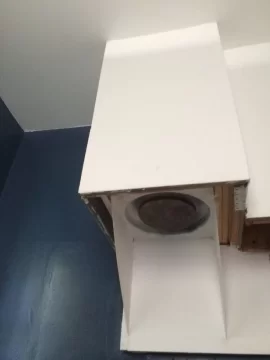

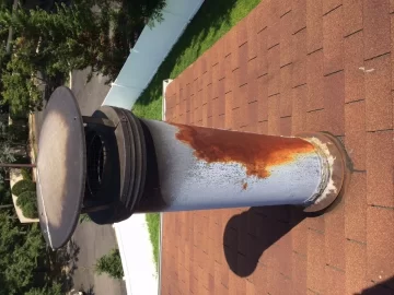

The house had an existing wood burning stove when it was built in 1979. There was a single piece of piping that went through my walls and out of my roof (Ill include pictures). I was informed that this was an old method and an air cooled pipe. There was no insulation I was told from the photos I showed them.
I had a couple places tell me I had to use all new 6 inch insulated piping (Secure Temp Asht+). Then I also had a couple places tell me that I was able to have a 6 inch stainless steel liner put down through the old 8 inch piping.

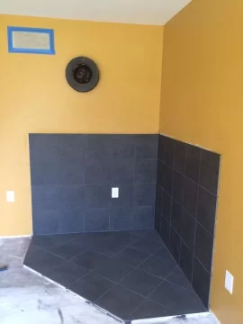

Photos are of the old piping and a pic I found of the old stove when the house was built. [Hearth.com] Liners[Hearth.com] Liners[Hearth.com] Liners[Hearth.com] Liners
So it goes through the wall and then up? not the best option and the chimney looks pretty beat i would put in new
With pretty heavy corrosion on the exterior part I would go with new stainless. I would bet the stuff that is showing heavy rust to be quite weak.

a liner is not a new chimney it would just go down inside your existing chimney and if that existing chimney fails which doesn't look far from happening your new liner would be worthless to you. I would recommend pulling out the entire system and installing a new insulated chimney system.

So the pipe goes through the wall with a 90, comes out and makes another 90 up, where that support bracket is? I don't have bholler's expertise, but it sounds like it might be cheaper to use what you've got to house the liner. You'd have to make sure about clearance specs of the old system, quality of installation, and weather that pipe is still sound. If money's not a big concern it probably would be better to re-do the thing from scratch. Insurance would be a consideration...

Well it could be same if the existing chimney is in decent shape and there is no liquid chimney insulation. The reason not to do just a liner is the fact that the liner will only be usable as long as your existing chimney is useable and by the looks of it it will not last long. I really feel that a liner would be the wrong decision And besides i am not sure how you would deal with the bottom you would have to add a tee to your existing chimney to get through that wall
