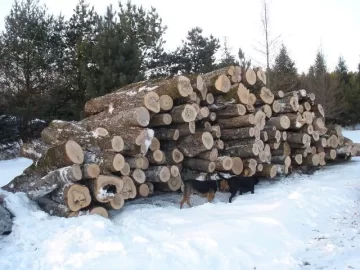

View attachment 153004 Here is a 10.5 chord truck load of mostly Hard Maple that my neighbor just bought for $1100. I scrounge all of my wood and its easy to do it up here but he won't do it so he buys a truck load every 3 years. This same load always went for $800 until recently it went up since the loggers are getting that much from the mills.
3yrs for $1100 still sounds like a deal , still looks like a lot of nice furniture could be made out of that pile it would be about $8.00 a board ft for dry maple lumber here.

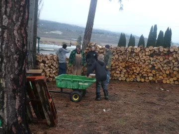

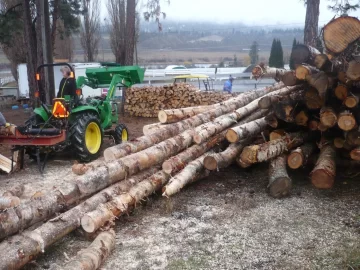

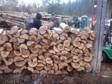

Have been working on the pile the last couple days, today had a full crew of family, my son and his wife 2 grandsons and my wife good progress.
How long do you season those half log, giant splits. I'd make 3-4 pieces out of some of those.

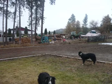

That is a great view behind your pile of birch.
I don't know why I'd split them any more, not making kindling we are feeding a boiler as big as a car at 75lbs of wood per fill.Our climate is semi arid very hot summers with almost no humidity should have no problem seasoning this wood.

Thank you for all your research on Birch , I had never heard of zipping the log. These logs were harvested with a processor which scored the bark full length. Do you think that is enough or in the event I don't get the whole load CCS soon zip them?
What is your target moisture content, and in September of what year do you want to be there?
If you are shooting for Sep 2015 and want to be under 20%MC wet basis (electronic gizmo) you probably want all that split to roughly 10x10cm not later than April 15 2015, stacked off the ground on pallets that are on cinder blocks, and covered on top with one good and one excellent among sun and wind exposure.
I don't see anything in there small enough to dry out without rotting using just a stripe or zip. You might have some little guys hiding in there, but the average size log in there (in Fairbanks) would to have to be split once, stacked off the ground left uncovered this year and covered next year to be at or near 20% in Sep 2016.
You weather, I hope, is a little warmer than mine. You might be warm enough to get away with splits at 15x15 or even 15x20 cm and make 20% in Sep 2015, not sure.
