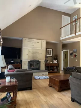

The house is 3100 sq feet total heating about 2000 of it with the stove, built in 2004, cape style, open floor plan vaulted ceiling with ceiling fan in the middle in the northwest corner of CT where we get cold and snow. I still have snow in my yard and it’s 17 degrees this morning.
I’ve had the NZ3000 for the last 6 years heating it and it does a good job down to about 10-15. Once it goes below that it’s a struggle. I have no schedule so it varies. I would like something that would heat through the night. The NZ last night was loaded at 10:30 and at 6:30 this morning I had coals to start a new load but the stove top was at 175 degrees. Warm but not heating the house really. That’s typical a typical night for the NZ.
[Hearth.com] Looking for Blaze King Experience [Hearth.com] Looking for Blaze King Experience

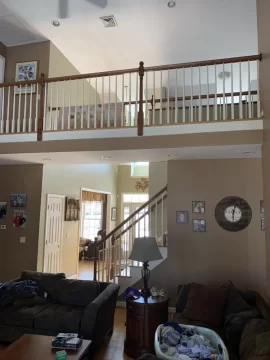

Here are pictures of the family room and looking towards the front of the house. The kitchen is behind me in the pictures and has an opening 10 ft wide by 8 feet high.
That's a big house to heat with a medium stove. Having a flush fireplace makes it even harder unless you are using ducted air, which the large chase kind of looks like you are.

It’s a stretch because the home is 3100 sf and in the pics a significant portion is double tall ceilings. Hard to say how the op reduced the heated area to 2000 but this is way way over what bk says the 30 box can do. Plus, experience has taught us that properly sizing a cat stove means staying on the lower end of what it can do.
Now if using this stove just to supplement central heat like some of our members then it doesn’t really matter.
