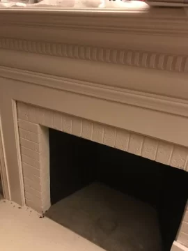

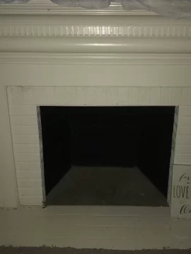

I attached a picture to give a visual representation. However I was measuring something else I misunderstood sorry. The Meaurment from the hearth to the bottom of the mantel is around 53 inches

All that wood trim around the fireplace opening might be an issue.

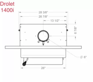

That doesn't sound like a huge FP. Depending on the taper of it, and where exactly the damper opening is (but that can be modified) you might only be able to fit a mid sized stove in there...I could be wrong...and I hope I am, its nice to have more options and not be limited by size...but the dimensions you listed are similar to the measurements of my FP, and I was limited to a 1.8 CF firebox (Drolet 1400i) and it was a really tight fit (at the back, not at all at the front) The issue was getting it to sit back far enough to get the flue liner hooked up, and also back far enough to meet the hearth requirements, as measured from the front of the stove, out.

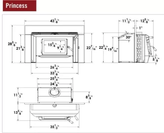

I would defiantly modify where I have to, I am really set on getting one in there now haha. Something interesting I seen, since you mentioned your fireplace is similar to mine. The layout of the Drolet 1400i versus the blaze king princess, It seems like if the Drolet would fit then the blaze king definitely would. From the reading that I’ve done it seems the blaze king is a sought after and superior unit. What’s your thoughts on this?

Great that helps. A large insert can fit in there as long as clearances pass. The Blaze King Princess or the Pacific Energy Summit look like they would work.
