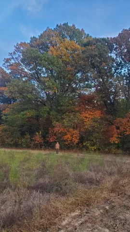

heres a picture of the tree. my son is standing in front of it. Its atleas 100ft.. most likely more then 120 ots a monster oak. there alot of wood here. the branches themselves are like tree.. the trunk is at least 4ft.. Ill be using the T590 with grapple bucket and the kubuta tractor to move this sucker.. normally no the scrounge I only bring 1 machine.. Ill use 2 for this as its near my home and I won't be saing the truck to hall log lenth

If they are that big, and if they are straight, sell the logs, or do something with them other than firewood.
They are that big and from the pictures they are straight. I can wait to start cutting and processing. My sons now 14 and he is eager to tackle such a big tree. I might even treat myself to a new saw for this one.. Im not sure how may cords are in this im guessing over 2 its alot of wood.
Easy. (Dia/24)^2/*L/85, with Dia in inches and L in feet. 85 is roughly how many cubic feet of solid wood you'll find in a stacked cord.
