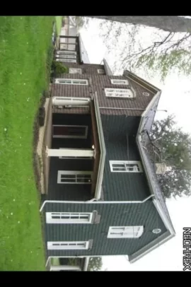

We're buying a very old and big house as a fixer up project. Will be living in it for the next few years as we fix it up. It's a house built in 1880 with 2300 sq ft. House has 2 chimneys and I am planning on installing 2 stoves. Leaning towards what Dennis has and ordering 2 Woodstock soapstones. It was between them and Blaze King but feel the soapstone would fit the house better. [Hearth.com] Looking to buy two new stoves

How about a layout and chimney locations on the house? I would be deciding based on what will work best for the house and for your schedule.
Example questions:
What are the locations? Is one more centrally located? Will either be in a smaller area with less airflow into the rest of the house? Will the stoves be on the same floor level? What standards are you planning on bringing the house up to with the remodel?
Another thing I would think about is with 2300 sq ft you should be able to do the majority of heating with one stove. If the layout will allow it I would be looking at one large stove and another smaller for the other.
If you give us some more detailed information we could look at it more objectively and try to give you some things to think about. Things like putting a small stove like a Keystone in a 1000 sq ft room open to the rest of the house would be senseless and putting a PH in a 10x12 room with one door and window would be senseless also. This is a perfect opportunity starting from scratch to do it right and you will be very happy if you do get it right. There are allot of good stoves out there, but picking a good stove and putting it in the wrong situation will yield less than stellar results.
Here is the layout of the house the picture is the first floor. I marked the interior doors, the upstairs is all bedrooms with one bath off the hall over living room. Figured both stoves on the first floor. The kitchen stove would probably do most of the heating. So that is a good idea to get a small and big stove. I'm thinking of also utilizing fans built into the walls to help move air around.[Hearth.com] Looking to buy two new stoves
