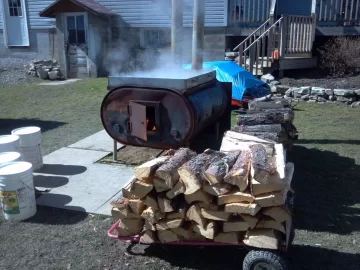

    Okay, so anyway, now we are using the big evaporator I built. It is a big homemade stainless pan that will hold over 50 gallons of sap in it. The entire bottom of the pan is touching the heat inside of the evaporator, it'll boil off close to 25 gallon of sap per hour if you are stoking it good. But it sucks up a lot of fuel! It's nothing at all to go through a heaping pickup load in one weekend! Here are some pics of the evaporator, and of our newer collection method:
    2012-02-12_12-19-14_543.jpg 2012-02-25_12-23-57_702.jpg 2012-03-03_13-37-09_101.jpg
    Anyway, some of my tips that I use. I keep my barrels of sap in my cold basement for storage during the week. I bring all the sap home (every evening) and put it in the barrels. Yes, it's a full time job that time of the year, but this maple business isn't easy. That's why imaple syrup is so damm expensive! I fire up the evaporator on Friday evening, cooking it right through the weekend. I dampen the fire waaaay down, fill the pan within an inch from the top, and go to bed late each evening, getting back up very early on Sat and Sunday morning to fire it hard again. I can easily boild off 400+ gallons a weekend by myself, but it's work. Lots of it. The sap likes to boil over, so a drop of oil or such to break the surface tension of the sap every now and then will keep that from happening. I use a little pat of butter every 100 gallons or so. Old timers would hang a piece of raw bacon over the pan. It would drip grease in the pan every now and then, doing the same as butter or oil. Start out small, set some realistic goals, and you'll be canning truckloads of it before you know it!
