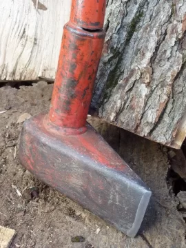

I was wailing away on a big old walnut round today. You know that mode you get in where it's you vs. whatever the inanimate object is, and you absolutely refuse to lose? That was me. I was really surprised this happened to be honest. It seems like really thick tubing. I can't imagine what it would have done to a plastic Fiskars.

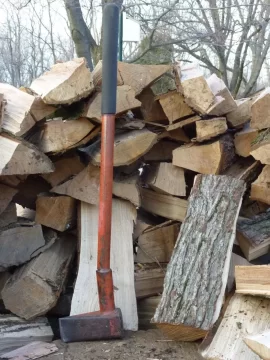

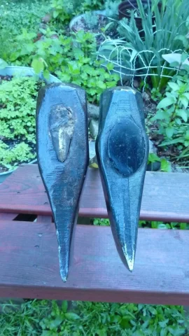

It happens. I think I'm gonna cut the handle off, then re-weld, plus a piece of angle stock along the handle, bridging where the crack was originally. Too much weight up there is gonna killya. If you don't have one, get an 8# maul and some wedges; The angle on the Monsta Maul is too fat for it to get started in really tough wood. You can see where I tried to make a little sharper angle. I do the same with my mauls. BTW, the Fiskars wouldn't break, it would just get stuck. :mad:

Oh, yeah, and work from the edges on big ones. ==c

I've seen a few MM's break just like yours. One friend heats his house 100% with wood, and the MM is his only splitting implement. He repaired his with a heavier-wall handle (it may have been black sch.40 pipe, I think). No angle, on the outside... I'll try to remember to ask him next week how the repair was executed. In any case, 6 - 8 years since the repair, and no failure.

Clean it up really well with the grinder - your weld will be way more important than the piece of angle as far as longevity. I am sure these are mass produced and failure is weld related due to poor penetration originally. Make two become "one" with a quality weld and forgo adding extra weight. JMO

I doubt that the failure was caused by a single, or even a few hits. It was caused by "cyclical loading", a million hits, each one flexing the steel and causing it to become gradually harder and more brittle. It happens at the weld for two reasons. First, the stress is concentrated at the point where the larger diameter meets the smaller one. Second, unless the weld was annealed, the heat affected zone is harder and more brittle due to the rapid cooling of the area after welding. In critical applications, it is common to torch anneal (heat to cherry red and allow to air cool) a weldment.

As far as your monster maul, I think MrWhoopee is dead on. The step at the weld is a stress riser and that appears to be a fatigue failure. That is not a new tool, it has probably seen hundreds of thousands of impacts. If you want to fix it, I think the best course of action would be to grind down the weld until you can pull the handle pipe out of the larger pipe that is welded to the head. Then you can replace the entire handle. Failing that, you could grind out the break to a nice bevel and find a piece of pipe that fits snugly inside the handle and weld it back on with a sleeve inside.

Clean it up and reweld it. Make a plug for extra strength. It isn't a space shuttle linkage. Then give it a nice hollow grind to reduce the stress on the weld, and Keep it sharp.

If you want to eliminate stress risers make 5 passes then file it smooth. It will stress relieve itself from residual heat. File it while it is still hot to save some effort.
If you are worried about metal fatigue end for end the handle.
Work from the edges! That's a big heavy round.. would take a HARD hit to split it right down the middle.
looks like it was a hard hit!!

The well-tested repair I mentioned above was a new Sch.40 pipe handle welded to old stub, with a 4" sleeve welded over that.
