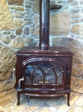

Sounds like a great idea to me! That photo ought to keep you motivated in the meantime.
Good plan. You'll love that Oslo.
I've got one for sale, although it might be gone this weekend. They are great stoves!

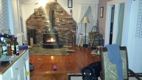

Built my cabin around the Oslo here. It's the only heat at -15 F
GF has the Oslow, first stove I ever had to run. I love it. It's an elegant beast, that thing can can get loaded right up and runs great.

If you look at the pic I posted by the dogs ball on the floor you can see where we patched the floor in after removing a wall and closet that separated the rooms. Before we took the wall out the stove room would get too hot to even sit it.
It now comfortably heats a 1200 square foot 1850s house with very little insulation and many original windows, and two more narrow doorways.
