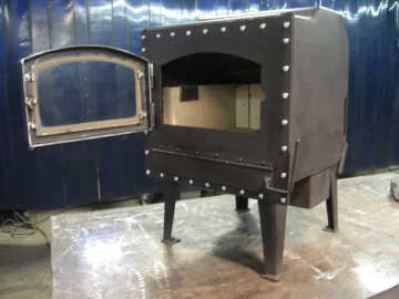

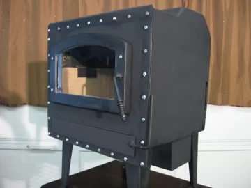

Hello everyone. I'm the guy that invented the Mini12. I'm finally able to manufacture and sell some of these little beauties. Thanks for the input and feedback. The Mini 12 is designed to give quick heat in small spaces with little fuel. (about 500 sq.ft.) The dude who tried to sell some for me DID exaggerate-I'm sorry for that. I'm currently building one with a cook top and also a 16 inch model.If anyone is interested, I'll set em up on Ebay until I get the storefront on my website. Thanks again. Lloyd Gray www.miniwoodstove.com

Does that door utilize a gasket?
Has it been or in the process of being UL tested?

I am curious as to how stable it is with a stand ? Is it top heavy or does it anchor down some how ?

Two things that I am going to have to pick on (sorry Lloyd). First is no door gasket and second is the use of gravity to hold the (I believe) ash pan lid down. These two items tell me that it is not sealed and therefore will probably not be UL tested and would not pass EPA phase two tests.
I think the concept is pretty cool. It appears (visually) to be a well built stove. I could see a niche market for it. I think it would have a bigger market if it was UL and EPA tested.

Thanks again for the feedback. Yes, the door has no gasket. Yes, the unit is top heavy with the stand. The foot pads bolt to the stand and the stand bolts to the floor or wall. Sorry, not trying to advertise-looking for criticism and advice. The unit has not been tested yet-still looking for backing and manufacturers-building on a shoestring.

With NO DOOR GASKET... Why is there an air control? No gasket means an air leak.
I wouldn't buy one. Just based on that. Thats a New technology stove (secondary burn) with Old School Technology (no door gasket?).

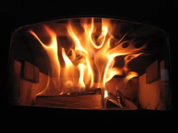

What provides the air wash to keep the glass clean?
For the next gen I would:
a. make the minimum size 14"
b. eliminate the bolt on front
c. gasket the new door
d. drop the tall stand and offer it with 2 different leg lengths instead

Here are my questions to the inventor, Lloyd:
  • Is the lack of door gasket part of the natural air intake of the stove. My secondary burner has door gasket but also has a few air intakes that are always open to keep the unit from smoldering.
  • Is there a reason besides budget that you left the bolts visible and a part of the aesthetic, instead of welding the front? Again is this a part of the intake (assuming that there are air gaps at the joints)
  • In the video HARDWOOD was pushed as though you shouldn't burn softwoods in this unit. Is there a reason for this? Many wood burners only have access to softwoods and have been burning softwood for generations.
  • Do you heat your house with wood currently? If so, what appliance do you use to heat your house?

Thanks again for the feedback guys. I'll try to answer your questions. About the door gasket- I'm going to incorporate one on the next gen. The ones I'm building now are very tight fitting and any small leaks don't seem to affect the performance. The bolt-on front serves two purposes- The first is easy access and maintenance should any brick or grate needs replaced, the second is purely aesthetic for a steam-punk industrial look.
All solid woods burn well in this unit, I burn softwoods also, I just recommend hardwoods because of the density (don't have to reload as often). A full load of hardwood will burn down in 1-1/2 to 2 hrs and the coals will relight quickly when pushed into the grate area.
We use the Mini 12 for secondary heat in our open 26 x 30 ft upstairs apartment. The apt is very well insulated, so a couple electric/oil radiators keep the place warm enough till we get home and fire up the mini.
There are two separate air intakes. one through the front under the draft plate and the secondary thru gill slots on the sides that feed the injector on top.
