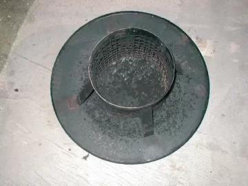

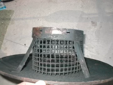

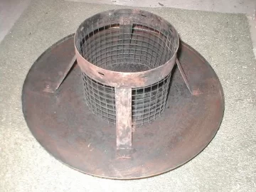

At this point last year, my cap was nearly completely clogged shut. This year, not much at all. The solution, dry wood!!!!!!!!! You can say your wood is dry all you want, but if your clogging cap & such in a month or two time, your wood is NOT dry.
2 cap before shots, 1 after shot

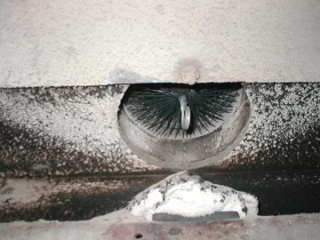

As you can see, 9-3' rods & chimney brush work well for me. You can see the brush at the stove outlet from inside.

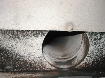

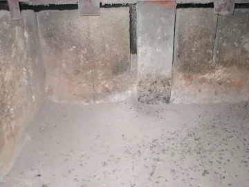

The debris from cleaning were very fine gray powder. I consider it fly ash. No black just gray dust.
I am very happy with the results of this mid season cleaning.
shot of liner pre cleaned, and the ash at bottom after sweeping liner.
  • [Hearth.com] Mis season insert & chimney clean out.
